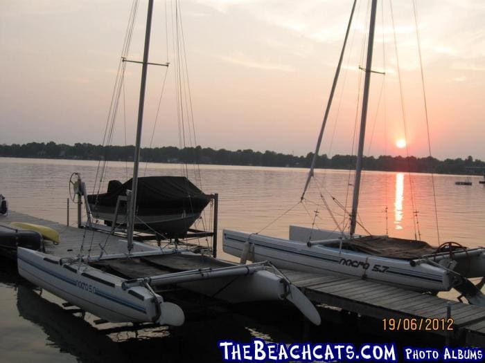

Here is the new addition, (5.0) it makes the dock look more balanced, no?
My wifes sister dropped in last week, she thought the blow boats made the whole scene beautiful, how can my good wife argue with her older sister? If I had the room you do I'd probably have a Cat for each day of the week.
This was after the sail, when everything had calmed down again.
