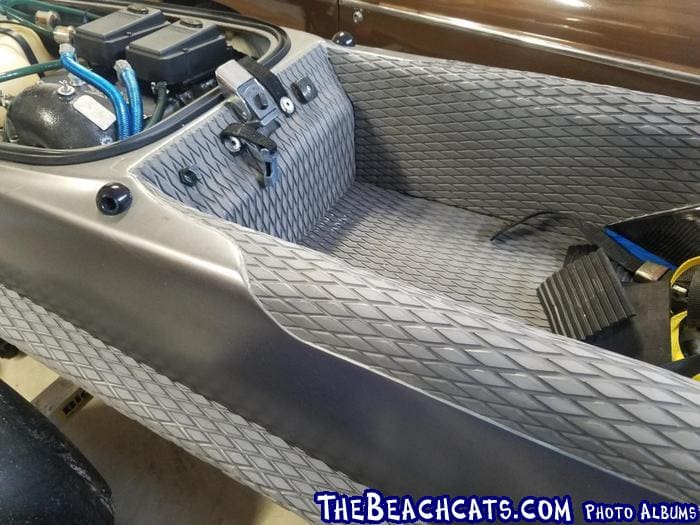

Here you go - here's a picture of a five year old turf job on my ski. Admittedly this is stored indoors, but you can see it's very durable when it's put on right.
Edited by sjbrit on Dec 09, 2016 - 12:05 PM.
