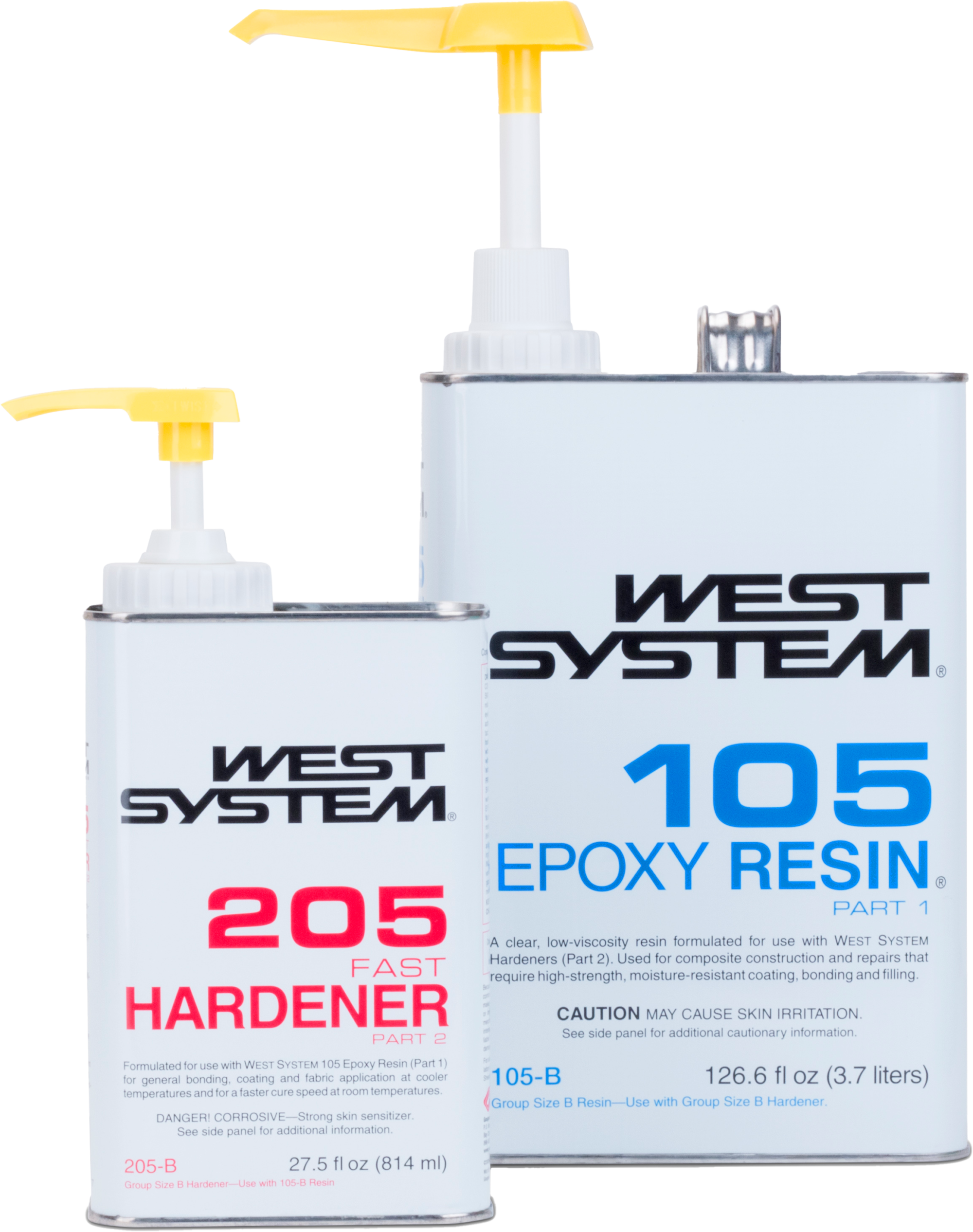

I had some West system epoxy that I "inherited" after maybe five or six years from a guy who rebuilt a wooden Wayfarer. Nice boat. Anyway it wouldn't harden. With fresh hardener it worked fine. So my exhaustive testing (once) says that the epoxy has a long shelf life but the hardener has a much shorter life.
205, the Viagra of epoxies

I had some West system epoxy that I "inherited" after maybe five or six years from a guy who rebuilt a wooden Wayfarer. Nice boat. Anyway it wouldn't harden. With fresh hardener it worked fine. So my exhaustive testing (once) 😆 says that the epoxy has a long shelf life but the hardener has a much shorter life.

west system that is old will have a red hue - this doesn't effect the strength
west systems suggest you put resin in a hot bath to resolve any crystals that may have formed
Posted : December 5, 2016 3:04 am
The Website for West Systems is back up.
Scroll to bottom of page for useful life information....both resin & hardener, "many years"

I use West System ALOT. Have a sail club with about 25 monohulls (mostly Sunfish) and about 8 cats.
I've become the resident repair guy.
I've noticed the same thing about it not setting up (on occasion) and initially chalked it up to poor mix amounts, but that's hard to do with West.
Mine stays in an unheated garage, and I do more repairs in winter than warm weather.
About two years ago I started bringing in the epoxy to a warm room prior to use and then stirring it up prior to use. Makes a world of difference and some of these epoxies have sat in garage for 2 plus years.
