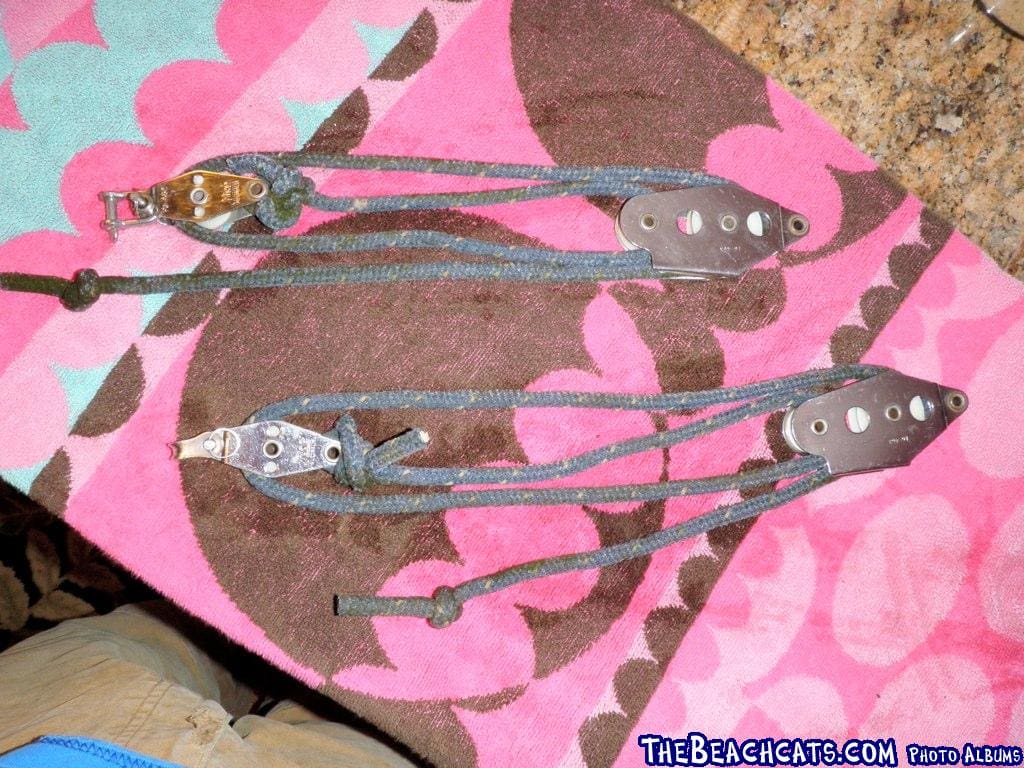

trapeze system I'd like to use

This picture is from the forums, and shows the 3:1 systems and the amount of room they need. This system is nice if you spend a lot of time on the wire and need to vary to length due to your position (fore and aft) on the boat.
On the "standard" system you show, you can keep the lines tight by varying the length of the shock cord or the total length of the rope moving through the small block..
Some people disconnect the shock cord altogether when they are on the wire, but I prefer the shock cord to keep tension on the dogbone to stay in my harness hook.
FYI, the forum is split on the Can't Miss Rings. Some of us have been dunked in the water by breakage due to hidden rust in the swages.

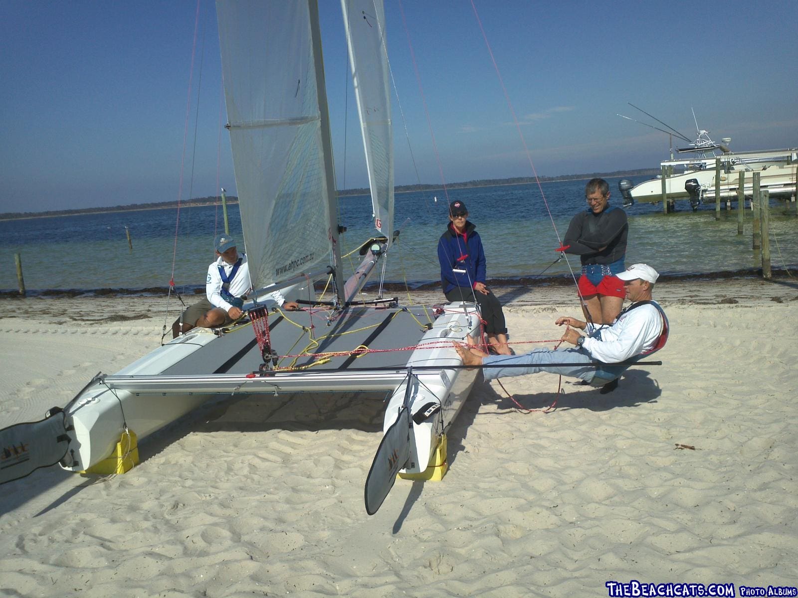

Late getting in on this, but I what Bob explained above is what I saw explained by Robbie Daniel (professional catamaran sailing coach) at his clinic before the Alter Cup.
He was coaching a team on proper technique for tacking and jibing from the wire and noted that their handles were too low, making it harder to pull your butt up onto the hull.
He basically said they should raise the handle to the point where it was as high as they could reach it, giving the best leverage for pulling up.
Check out Robbie's coaching rig, probably the only catamaran sailor I've met that could justify owning a F350 truck. 😆
