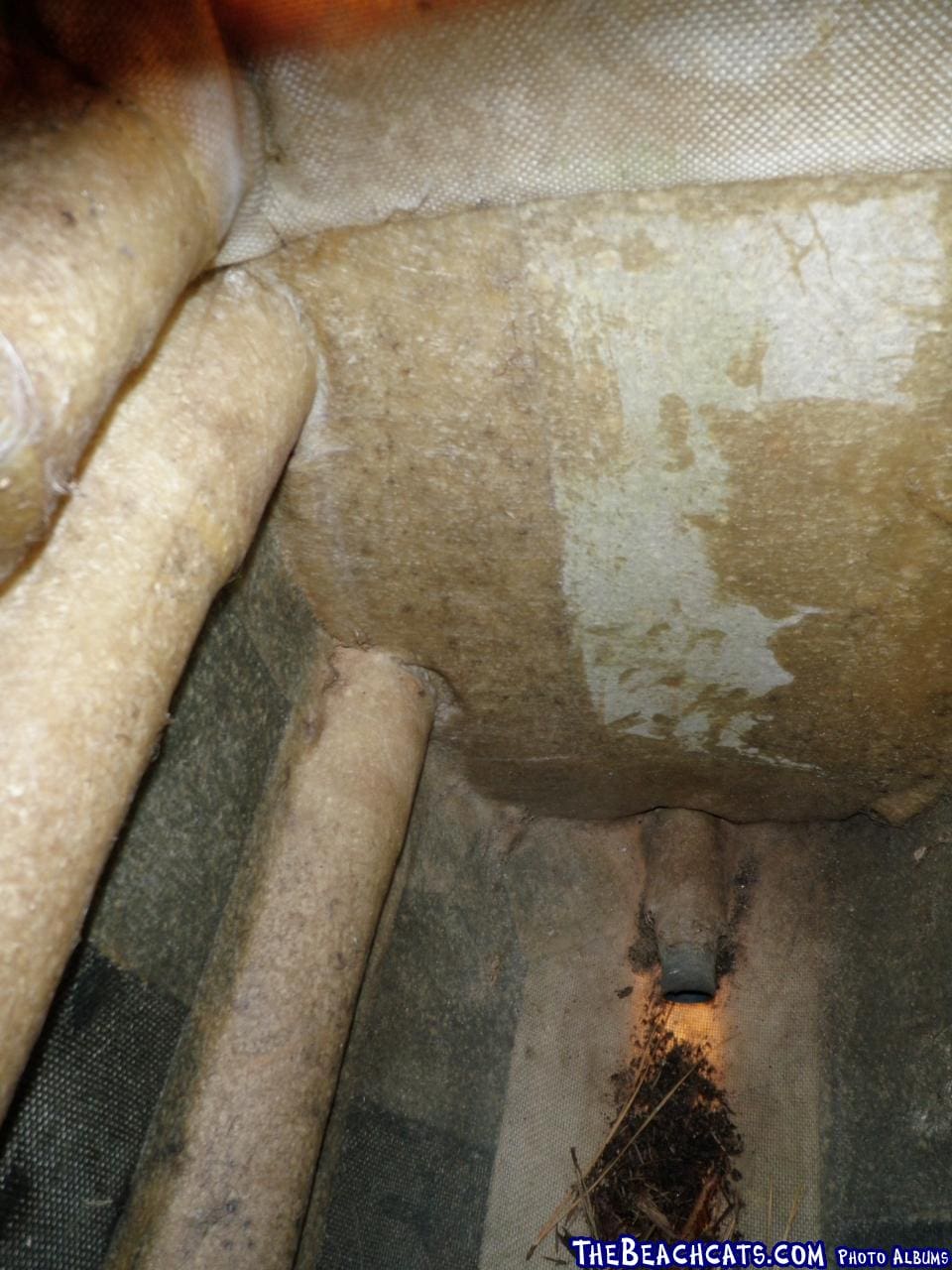

Here is a pic of the hole/channel thru the bulkhead in my 5.2. It could easilt get clogged. You could use a fishing tool for running wires in a wall to clear it.

Forward of the mast, there are no inspection holes to see if the hull has broken free of the stringer. (I assume the stringers are the rounded shapes that gcamick shows in his picture at the mast access hole looking forward. Do these stringers continue on to the nose of the hull?).

yes, the stringers are the half circle shapes and they go the full length of the hulls
