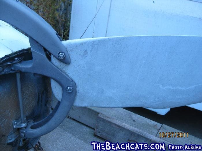

These rudders were on a Nacra 5.2 that got wrecked. I'm wondering what Hobie they were from originally. I'd like to sell them as tiller/casting /rudder, or the complete setup with tiller tie bar, but I don't know what model they were from. Clicking on photo will expand to full size.

Looks an awful lot like my H18 castings. Same rake adjustment screw is visible in bottom left of first photo.
Upper gudgeon on the transom looks original. Lower one was replaced with Hobie style.

That is the 'new style' Hobie 17 or 18 rudder system. Looks like the rudders are the older, softer style--the bendy ones.

Thanks guys. I believe the blades are a plastic. I'm not sure what is is inside, I never messed with them. There is a stainless bolt head about 1/2 way down the top curved part of the casting. I should have taken a few more photos.
They work well, a pull on the arm to flip them up or down. I like that they lock up. My Nacra uses the bungees & while it works, it seems the bungees have to be replaced every season. Once they start to wear the rudders hang down a bit, then I have to be very careful sliding the boat back on the lift, or they catch on the frame.

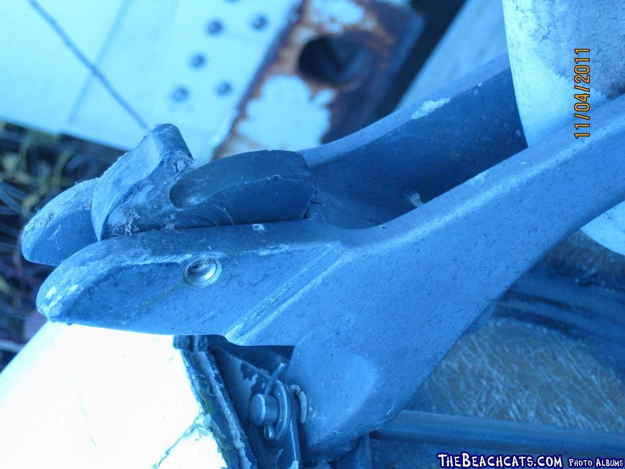

I took a photo today of inside the rudder guts. The "block" that is bolted onto the top of the casting is aluminum. The weird shaped thing inside is some kind of delrin like material. The tiller arms are straight.
Does this make it the "new" system? They seem to work quite slick.

Edchris177 wrote: I took a photo today of inside the rudder guts. The "block" that is bolted onto the inside top of the casting(not visible in the photo) is aluminum. The weird shaped thing in the photo is visible when you pop the tiller arms up, is some kind of delrin like material. The tiller arms are straight.
Does this make it the "new" system? They seem to work quite slick. Thanks, I don't know much about Hobie rudders.
Posted : November 4, 2011 2:01 pm
Yes, those are the good ones. Look in good shape, the plastic cam can be replaced when it gets badly bent or cracked, the replacement kit comes with a special screw to replace the current rivet holding them on.
Lube with some white grease or whatever you have handy for best operation. The tension of release is adjustable by the plastic screw that comes up from underneath and compresses a spring inside.
It's good maintenance to make sure you can turn that screw, remove it and clean the spring and top plug and replace.
