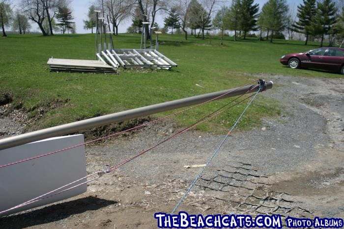

It is bag launched,(plan on midpole setup later, but for now it's old school). I figured out most of the rigging, however the halyard had been pulled out of the spin pole, & there was no way to restring it without getting at the internal double block. Here is an older photo of how it was strung, you can see the double block mid photo. All these lines/blocks are now internal & turning block at end of pole removed as the line dead-ends at a hole & exits through another hole, visible in photo below..

I have 3" Harken Ratchets on the REAR BEAM, with a cleat behind them. The photos the PO gave me show the sheet being a continuous through these two block, sort of like a jib sheet. You can see the bitter ends at the blocks attached to the spin at the top left of photo. (Yellow line blue trace) They then travel outside the shrouds to the block on rear beam, through it, across the boat to the other block, & forward, around the the other small block on the spin.

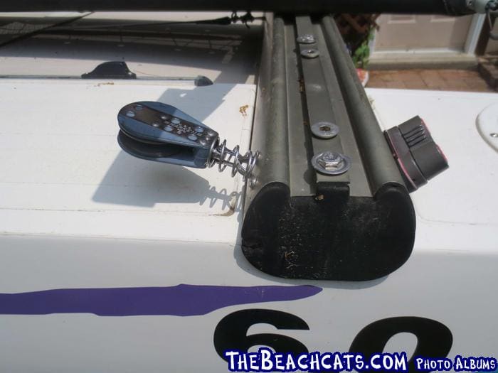

The cleats are separate from the block, looks like this. Don't know how the cleats were intended to work.
