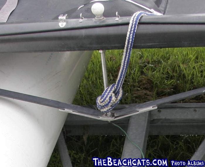

these are some photos of a friends trac 16 that has had a reinforcing repair on the dolphin striker. i'm not sure if the original part is still in there but it looks like it is. i'll ask him if he has any other photos before the repair and if so, i'll post them. not sure if this helps.

How did you make out?
I measured the V-strap from the Nacra, it is 1.5" wide, same as your Trac. The Nacra "saddle" will fit. They are "soft secured" to the V strap using adhesive silicone, or something like Dow 5200.
If your DS rod is 1/2", the easy mod is to find a piece of tubing with an ID of 1/2", & OD of 9/16". It could be plastic, aluminum, copper etc.
Cut off a piece, 3/8"- 1/2" long, slip over the DS rod end with a bit of JB weld or Dow 5200 to stick it to the rod & you're good to go for another 25 years.
The force on the rod is mostly vertical, the bit of tubing just shims it to fit the divot in the saddle.
