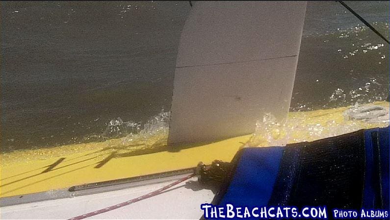

2 years ago I flooded a Hobie 18 port hull (1986), on Galveston Bay. Discovered the problem when the boat tried to pichpole and didn't immediately sort itself back out when we dumped both sails.
The flooding was caused by cracks opening up at the outboard front and rear crossbar joints and the inboard front crossbar joint of the port hull. I had the foam blocks in the hulls.
We put the crew on the starboard hull (leeward) and were on a port tack, the port hull was awash most of the 7 miles back to the beach.
When we got to the beach, the boat ran aground in about 6" of water. We opened the inspection port, and found that there was abour 2" to 3" of the hull NOT filled with water. I pulled the drain plug to let the water level equalize, then floated the boat onto the wheels to pull her out. Not fun.
I think that without the reserve bouyancy of the foam we would have been in deeper doo doo, and had to swim some...
YMMV
E.T.A. - The head pressure (hydrostatic) of the water in the hull blew the drain plug out of the through hull fitting when I unscrewed it.
http://www.thebeachcats.com/pictures/?g2_itemId=103830
