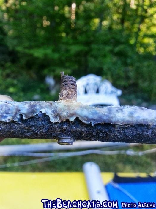

Partial hijack about to happen. I am in the process replacing the standing rigging and I just found out that the anchor bars for my bridle are fused to the bolt. I was thinking of cutting the heads off the bolts with a dremel. Anybody ever have this issue?

peterk123, this is exactly what I stated in post above. Inner stainless bolt first fuses to aluminum bar stock, later it pulverizes aluminum which then breaks. Must be watched carefully on P-16 & 18's used in salt water. Pete

if you have an impact driver the heads will snap off. I replace mine with new aluminum ones and they fused the next season so I made a set from stainless bolts...drilled and tapped them.

Thanks guys. I just posted the pics and how I removed the screws in the technical pics section. All hail the dremel 🙂
I just ordered new tangs, screws and anchors. I will apply some grease to the screws and check them often.

That doesn't look like stainless or aluminum to me!
