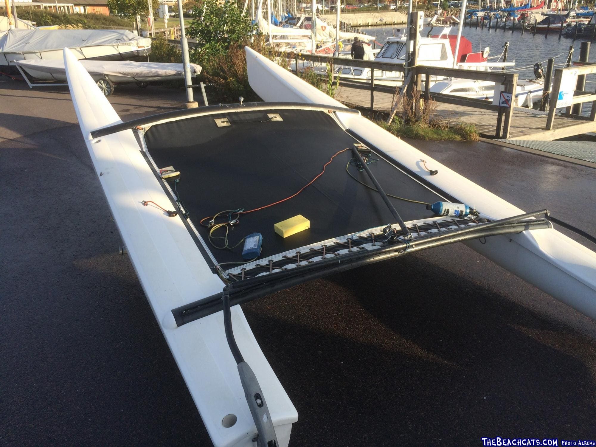

Hi All,
I picked up and old hobie 17 the other week. I'm experienced in dinghy and keel boat sailing, but the catamaran thing is new to me. The seller didn't knew either.
The boat came with a jib (possibly a super jib) but no bow spreader pole.
Question is how to sheet the jib? In attached picture is a rope on the trampoline that connects to small cleats on right and left side of the rear cross beam
The jib has attached sheets and blocks, but where do I mount the blocks on the boat?

What i have is an endless rope going from a small cleat in the corner hull - rear beam, under the trampoline, back to another small cleat in the other corner hull - rear beam and then up on the trampoline. What to do with it...??

I don't have any blocks or cleats attached either to the front beam or to the hulls. So how do i sheet the jib?
after looking at your pics it is my GUESS it may have never been set up since there aren't blocks on each side of your cat
Are there other parts that make you think it was part of the boat?
That sounds like a "run" for the trapeze bungee. it goes "Criss+Cross" (forms an "X" under the boat) to provide extra bungee, which is a valuable thing to have if you ever Peter-Pan (stuff the hulls and get thrown forward infront of the boat, while still attached to the trap wire)

Posts: 4069
I agree, don't see any signs of a jib setup. Just sail it. Looks like a nice boat.

To further confuse i post some photos i just took of the boat.
jib, furler, jib sheet and jib block:
Can it be so that the schakle seen on the trampoline shall be attached with the jib block/jib blocks?
The small cleats on both sides of the rear beam:
The line goes under the trampoline and comes up on the other side. I don't see that this strange line/rope has anything to do with the trapeze bungee and no criss-cross at all.
