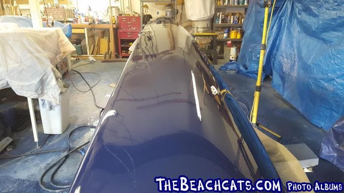

I can't begin to tell you how much work has gone into spray painting my boat This End Up with the Perfection paint. I have sanded off more paint working through the challenges of this stuff until I finally got the right setup. But now I have it sorted it out and the paint is stunning. There are some super small imperfections and I'm not sure what caused them, maybe dust, maybe something happening in the spray gun, who knows, but they are tiny and relatively few. You have to put your face right up to the hull to see them.
Interlux does not recommend that mere mortals spray this stuff and I can understand why. It is the most tricky paint I have ever encountered, ever. It is also toxic as all get out. But when it works this stuff is crazy glossy. I found that spraying the hulls on their sides was one of the key things that started making the finish work, but mainly because with the lighting in my shop I could finally see when I was spraying too much or too little and the difference between those two conditions is microscopic with this paint. Too much and it looks good for a while and then creeps into a run. Too little and the surface is dry and looks like crap. I can attest to all of these conditions after sanding all of them off. This has been one very expensive learning session and I will admit that I about gave up and took the hulls to a body shop, then tried one last little setup change and struck pay dirt.
I have just one more side to spray and then it will be time to assemble the boat. One hull is finished and is ready for assembly now. The Awlgrip 2000 gray on the aluminum stuff looks fantastic with this dark blue. Soon some wild tangerine sails are going to show up and this will be a show stopper of a boat. What a way to spend a summer, sanding, sanding some more, more sanding and on and on.
Here is what it looks like a few minutes after spraying:

Oh my! You win! What size batches did you end up making to spray? What was the spray equipment and nozzle opening?
Posted : September 22, 2016 3:41 pm
(@Anonymous 32247)
Posts: 258
With the spray reducer it worked out to about 17 oz. total, 8 oz. of blue, 4 oz. of catalyst and 4-5 oz. of reducer. Which was enough for one side of the hull and the deck, or the boards depending on what was up. I had less runs with the 1.2 mm tip and then set the paint volume very very lightly. As I mentioned the biggest breakthrough was lighting. When I had the light right you could see the build and could tell what speed to sweep. When I first started I had the hulls hanging like you had, but with my shop lighting you couldn't see the critical build process this goofy paint needs. I think spraying out in the daylight would be easier than inside, but then you have to sort out a shelter to keep the dust out.
I have a 5 hp. two stage compressor, the gun is an Eastwood HVLP in the mid price range that has worked really well for the furniture projects I normally do. I was messing with every possible setting to get this stuff to work, pressure at the end of the hose line, pressure at the gun, paint volume, pattern you name it, I did it and then got to sand it off. I could get to this result faster the next time, but I seriously doubt most people would be willing to buy all the paint I did, or to do all the sanding to get back to the starting point. If you want the super smooth surface, pay your favorite autobody guy to do it and then go sailing. This turned out to be the project from h.... I seriously almost gave up. I started thinking that maybe the pressurized systems that the pros use could better atomize the paint and I think that is probably true, but the HVLP system will work, it is just much slower.

Very impressive work. I recall when we first discussed Perfection in June, you were pretty excited about it, and thought it might be a shortcut compared to sanding gel coat. That certainly was not either of our experience. It does end up with a very nice finish, but I think I would have to sand to bare fiberglass and start over to get the results you got.
