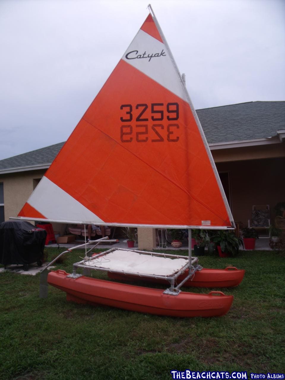

Posts: 4064
mimetattoo wrote: but i want to do it 10 feet long i never see one in this size and i want to do it ...
Any particular reason you need it to be 10 feet? Need to load it in a truck or something?
There have been a few beachcat models that small, but they tend to not be able to carry much weight at all, more for children. The Catyak was only 8 1/2 feet long.
http://www.thebeachcats.com/pictures/?g2_itemId=48223
