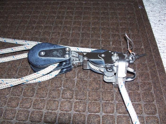

check out how to thread your mainsheet through the blocks at.... http://www.thebeachcats.com/index.php?module=pictures&g2_itemId=63029
