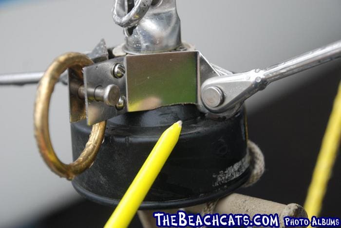

I had to shave metal off of yoke on the furler to ensure easy alignment of the holes. Not sure why the yoke didn't clear the spool housing.

The "yoke" you are talking about is the tell-cat (specific type of wind vane) hobie 18 bridle adapter. If you are not going to purchase the tell-cat wind vane then you can just remove the bridle adapter.

goodsailing wrote: I had to shave metal off of yoke on the furler to ensure easy alignment of the holes. Not sure why the yoke didn't clear the spool housing. What is the yoke used for? I see no purpose for it. Unless of course if you install a brass ring and run your anchor rode/ retrieve line etc. I intend to buy a shackle and pulley to make the furler line work easier.
That's a mount for a bridle fly..
not sure what you are talking about here
goodsailing wrote:
What holes were you trying to line up? Like said above if you aren't using that particular kind of bridle fly (I like it) then remove that extra bracket.
The bridle wires stay attached to the furler all the time so you shouldn't be needing to line up those holes during rigging.
You either disconnect the jib halyard forestay adjuster from the furler, OR as some have suggested, disconnect the ends of the bridle wires from the bows.
The bracket now identified as bridal fly, through that, trough the bridal stays, through the yoke pt# 61980000. Sorry it was the bridal fly, that was shaved. Now that I know what it's for. The metal wasn't bent either. I may be able to adapt my Laser wind indicator, fly etc somehow. But it could be used as a haul/ anchor line, right, or better from bow stays as previously mentioned?
Yes, next raising will include pulling the whole unit down and attaching bridle wires at the bows.
Posted : April 14, 2015 10:01 am

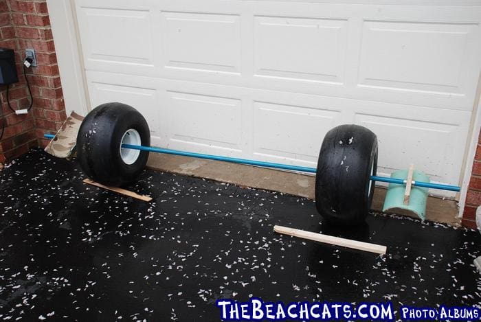

goodsailing wrote: But I did pull them port to starboard and then back again... snagged up so I removed the bungee. The bungee caught the lip of the older block, org equip, housing.
yard sailing is great for a dry rigging (and real fun with 2 sets of beach wheels), but i (personally) would wait till i had OTW time to make modifications

Thanks for the tips...
Should I use the carpet. Won't it just cause drag when pushing the wheels under the boat.
Posted : April 29, 2015 12:07 pm
goodsailing wrote: Thanks for the tips...
Use it. Yes it will create some drag but you want a little drag to keep the boat in place. Especially when putting the boat on the beach wheels in the water.
Posted : April 29, 2015 1:49 pm

OK, Beech Wheels done. The proof will be in the sand.
