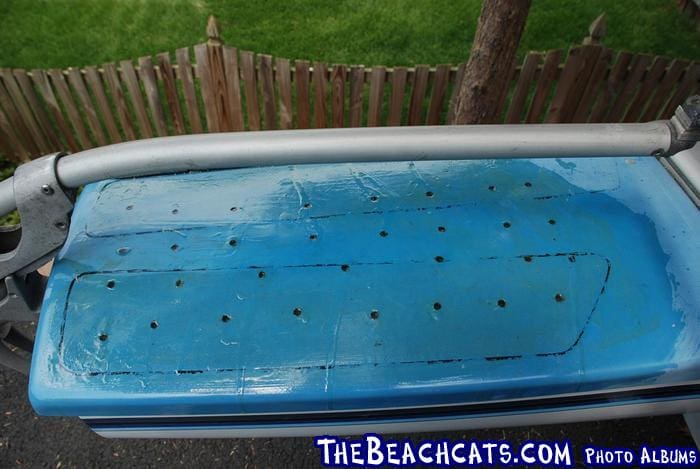

OK, here's the pic of the fixed aft hull. Tighter than Bruce Jners yoga pants. The horse syringe was useful for the first few injections but then I resorted to pouring it in using the paper cups that had the rolled tops cut off. I wouldn't have been able to do that with plastic cups. It took several set ups to fill. As mentioned before the tape prior to drilling was not worth the effort. I'm not worried about looks as if I decided to do the hulls this will be wet sanded before painted. Who said epoxy won't stick to gelcoat... notice how it deepened the color...
what kind of epoxy?
what kind of filler used in epoxy (if any)?
did you prep the blue gelcoat (sand? anything?)
How spungy was the hull?
what are those marker outlines for (or whatever those shapes are that take up most of the surface)?
Edited by MN3 on May 05, 2015 - 03:38 PM.
what kind of epoxy?
I'd sand everything down to mostly level with hole tops as they are rough, 10 minutes, fill if needed then paint. Was a tad crunchy, yet spungy in the center about 2" wide strip the most recessed area that took most of the resin. The cool thing about this is that the repair will most likely outlast the boat... I wouldn't consider doing a complete hull top as this little section took nearly a pint. Just want a structurally sound hull with little attention to how it looks at the moment. Not sure the markers.... part of the design... not decal; not sure.

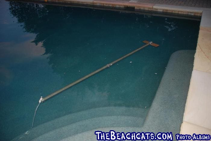

Righting Pole: I was going to use an oar but found them too expensive. I just happened to be in an military surplus and saw these fiberglass antenna tubes. I bought 2 for $6. Total cost is under $10 considering hardware. It won't float now but after I stuff them with noodle section I suspect it will float. I put an adjustable line on it that will attach to the righting line that is affixed underneath the hull. All I need to do is get the pole out and attach it to that line. I'm sure it will hold the weight but again: we'll see if it works. The cool thing about this is that you can break it down for storage. I plan on keeping it in two section while sailing then if I need it, just put it together to use it. I used Paulownia wood for the base, a wood that is light weight and won't degrade in salt water the same wood I'm using to build the Hawaiian outrigger. Parts strip planked and others stitch and glue..
This pretty much concludes the amount of work I'm going to do on the boat as it is time now to go and sail it. I appreciate all the fine tips and encouragement along the way. This is a great site and you guys are fantastic!
I'll post here once I sail it to let know how I made out with the boat. Which if windfinder is telling the truth, it could be as early as tomorrow.
It looks good! I liked the idea of attaching to the righting line, it's a good good improvement compared to rolling a line around the pole. Managing the line with bungee underneath the tramp, which is what I did, is pretty complicated too.
I suggest to try it dry first, it's not hard to capsize the cat on the beach. I would check if the pole resists your weight. I broke an aluminum one the first time so on my current I have also a central line for more protection. it's probably not really needed but I preferred to avoid any risk. It seems a bit long, on the dry test you may find how much length yo really need (plus an extra for wet sails, etc.). I think that lateral movement of the pole could be an issue, if your adjustable line is too long it might not be stable enough. Why not just attaching righting the line directly to the pole? That would allow an attachment point not so far back on the pole and would improve its resistance. (you may walk even past the attachment point if necessary)
Andinista wrote: It looks good! I liked the idea of attaching to the righting line, it's a good good improvement compared to rolling a line around the pole. Managing the line with bungee underneath the tramp, which is what I did, is pretty complicated too.
I suggest to try it dry first, it's not hard to capsize the cat on the beach. I would check if the pole resists your weight. I broke an aluminum one the first time so on my current I have also a central line for more protection. it's probably not really needed but I preferred to avoid any risk. It seems a bit long, on the dry test you may find how much length yo really need (plus an extra for wet sails, etc.). I think that lateral movement of the pole could be an issue, if your adjustable line is too long it might not be stable enough. Why not just attaching righting the line directly to the pole? That would allow an attachment point not so far back on the pole and would improve its resistance. (you may walk even past the attachment point if necessary, which wouldn't be possible with the adjustable line getting on your way)
Good tips, yea I need to adjust when having the boat tilted the reason there's an adjustable knot on the line. I'm not sure having a sliding snap on the righting line would work but you'd find center pretty quick. I may just be able to lay the pole inside the righting line loop etc no knot or adjustment. Yes I could move the eye bolt further in but this pole is pretty strong. I'll start with max leverage then go from there. These are two 4 foot sections= eight feet.
