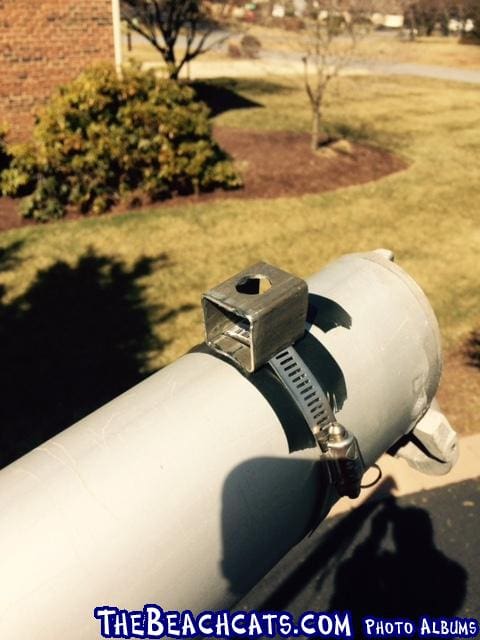

goodsailing wrote: Just thought about this: you could run a screw driver through there, which would hold the boom in place... Never thought of that till this morning...
Somebody has to say it.. This hose clamp and square tube... they just don't belong there...
You know it works, test passed, you made your point.. Now it's time to solve it with elegance, don't forget that you are a honorable representative of the cat sailing community..
Well said. We've talked about simply drilling the hole. Would a hole belong there too. Or simply remove the device when not in use so to not offend any honorable rep or peer? We're talking about aesthetics now. I suppose prior to the advent of a boom, the boomless captains gazed a curious eye at that board hanging off the mast. Then as people used a boom as a part of the sail rig they became common, and elegant...
OK, I'll add powder coating, your choice of red, white, black or even silver to blend in etc.. and I'll throw in free shipping... this all in fun of course. get some retractable beech wheels in the hulls and then we'll be sailing 😆 Thanks for all your help thus far.

Andinista wrote:
QuoteThe spinnaker pole mount for a Hobie 18 is a gooseneck fitting.
It must rotate 90 degrees. From the pic I saw of that fitting, won't allow the movement needed.
Even if you could find the right piece, I wouldn't mount it on the beam, it would put a lot of stress on that connection when the boom is vertical.
H18 spinnaker pole mount (which is the H18 gooseneck mount) should work fine. What was shown in the earlier post is a Getaway spinnaker pole mount. The H18 mount is different and is rotated 90 degrees. Regarding stress on the fitting itself, we're only talking a couple hundred pounds here max. The fitting should be capable of handling that. The other advantage (in addition to removing that block of steel from the front of the mast) is that if you ever decided to install a spinnaker on your boat, you'd already have the mount in place.
Another thought would be to create a bracket that installs around the mast step and is held in place by the mast step pin. Then once the mast is up, the whole bracket is removed. That's probably the route I'd go and in fact, I would make a separate pole specifically for stepping the mast and forget about using the boom.
Good points especially adding spin later on. Good... , for the bracket you're talking about would be a 3 sided strip metal with holes for pin, same pin, screw driver, that holds the hinge and same hole I have here, to hold any pole, boom etc., That would rotate verticle above mast for pole installation. You could use just a piece of strip metal, bent twice in vice to form that piece, less work than cuting clamp slots as I've done with dremmel. Good thoughts. I'll make one up. The 3 separate blocks on the boom were cumbersome to deal with changing lines etc. That perhaps a couple of triples already rigged on separate pole would be easier, but adds to cost and more stuff to haul. Thanks for you inputs...
Here's the plug for the hole in the mast idea... something like this I had in mind if anyone wanted to go that route.
http://www.componentforce.com/category/504/silicone-cone-caps
Plastic might be better if it could be located..
Why! That was Goodsailing's best contribution in my opinion
Posted : April 9, 2015 4:54 am

The hole is an elegant solution to my standards. Even better with a plug (except for the color maybe). A well finished permanent fitting too. What about the Laser boomvang fitting on the boom side, that would work with a screw driver?. (Or a dedicated pin, even more elegant..)

Goodsailing, I'm not against innovation, testing weird ideas, thinking out of the box, etc. I was just suggesting a better finish!
Using the boom is a nice idea if it can actually work in a simple, elegant manner. The problem is that it looks to me that it is proving to be more trouble than it's worth. Re-stringing the main sheet system each time with a longer hoisting sheet would be a PITA. Working around the existing gooseneck fitting may prove to be more cumbersome than worthwhile. Sometimes when you restrict yourself to using one piece of equipment, you end up placing a lot of limitations on what you can do. Yes, using the boom is nice from a minimalist point of view and getting two functions out of one piece of equipment, but if you can do the job better, faster, more easily, and more safely with a dedicated pole, than that is probably better. We're not talking about a lot of weight, space, or extra equipment to have a dedicated pole.
Ah gosh... jeesh, chop saw, drill press etc.. throw a bunch in the powder coating machine and you'd have many parts. They'd look OK. Or spray with Rusto paint before install. I would have done that but didn't have time... because I didn't know if it would work or not..
