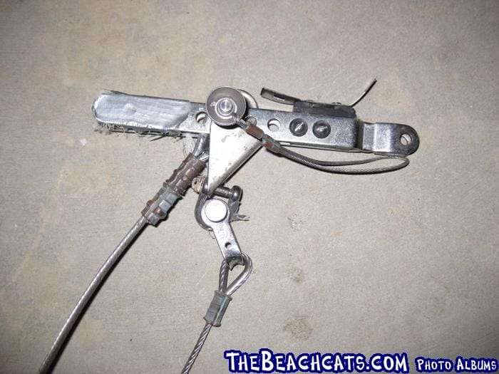

Gary, here is a picture of my bridle as it came off the boat.
Cable on left is forestay. Cable lower center is jib halyard. One shackle is to attach to head of jib, the other to attach tack of jib to the stay. I think previous owner just attached them together when they stored boat for winter. I'm not sure what the tang with 2 square holes that is bolted to chainplate is for.
Anyone have any ideas?
I also noticed they used a quick connect pin to secure the forestay...that is definitely going to be replaced.

That is pretty much the same as mine. The tang is for a Davis type wind indicator. I actually don't like the way the 2 bridles are attached to the chain plate. I put a bow shackle on the chainplate and one on each bridle wire to attache them together, it's a bit more money but a cleaner setup.
That type of quick connecter is pretty secure, mine came rigged similarly and I ran it that way without any problems. I did switch to a normal pin and ring ding though about half way through the season, and I wouldn't trust it on a roller furling rig.

Look on page 39 of the nacra manual for the proper way to rig this portion. The other part questioned in the photo is for an apparent wind indicator, it allows you to remove the indicator while not sailing.
