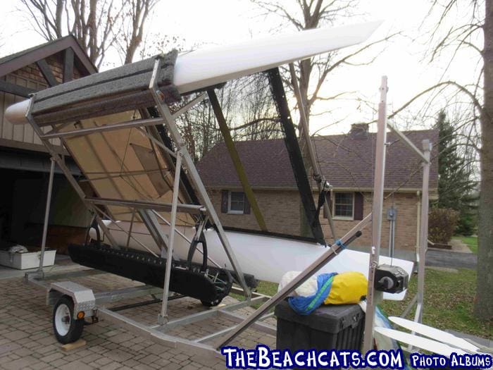

Here you can see the electric winch mounted on trailer. The pole, with sheave, extends upwards & is then pinned, to create an easy pull angle
Edited by Edchris177 on Mar 26, 2015 - 08:49 PM.
Here is how the electric winch works.
I put some photos in an album, it can be found in TECHNICAL, Trailers.
here;
http://www.thebeachcats.com/pictures?g2_itemId=113144
