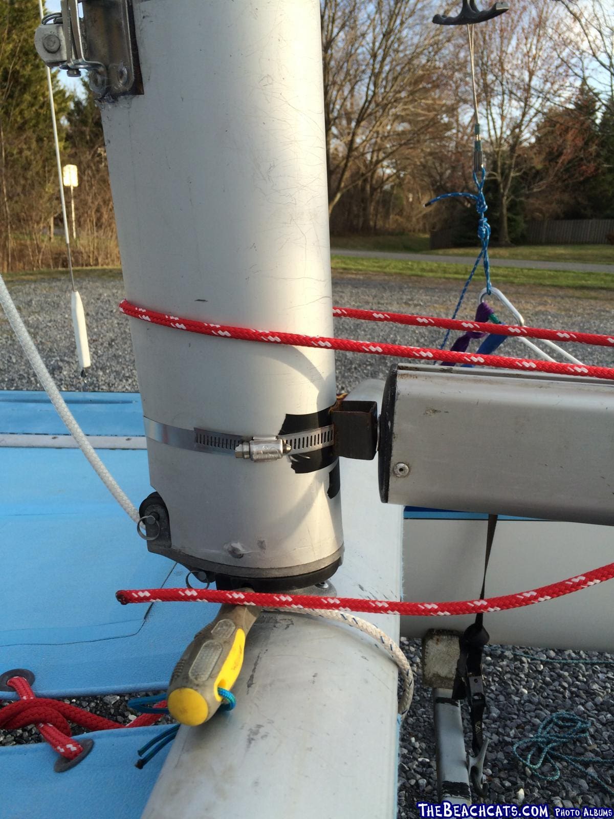

Success at last. The hinge came. And I used the H18 boom to raise the H18 Mast. (I wonder how many have done that since the advent of the Hobie Cat.) Here's all the pics in my gallery.
http://www.thebeachcats.com/pictures?g2_itemId=113043
Not sure why these pics don't show in posts?
Posted : April 7, 2015 2:43 am

For those who don't want to drill a hole in their mast....
OK now on to fabricating a part that involves a hose clamp, and 1" piece of metal tubing and since this is sailing hardware.... $125 Guy's just love gadgets... 😆
Added: rubber plug to fill hole in mast you drilled. $14.99 👿
Edited by goodsailing on Apr 08, 2015 - 08:11 PM.
Posted : April 8, 2015 2:04 pm

Just thought about this: you could run a screw driver through there, which would hold the boom in place... Never thought of that till this morning...
Posted : April 8, 2015 11:43 pm
